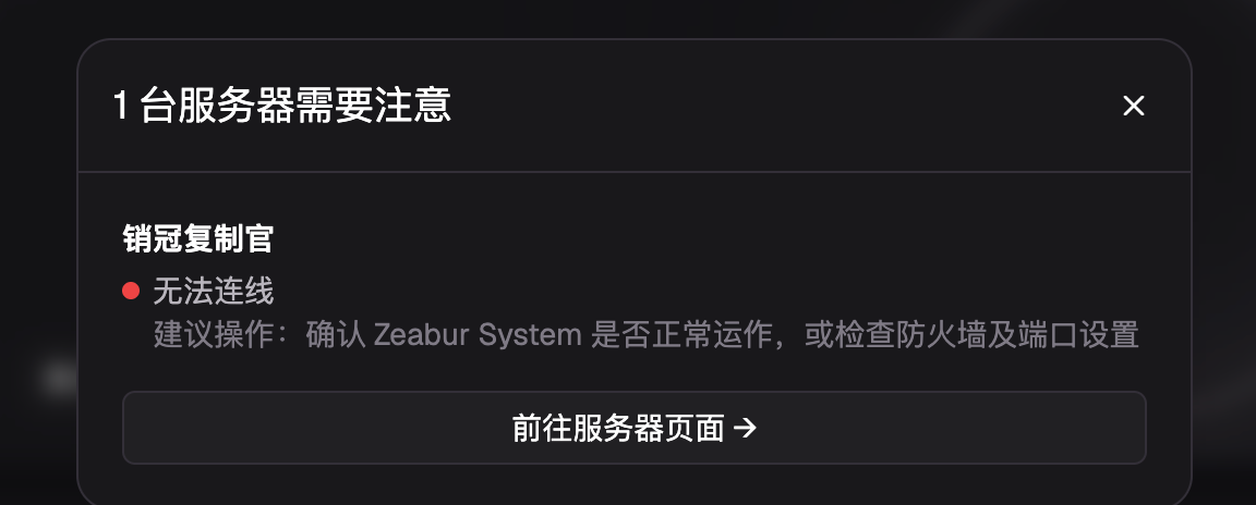

My server went offline unexpectedly, and the k3s service in Zeabur is showing red. Reinstalling the k3s service also results in an error.
Hello, I have investigated the issue from the server side:
Root Cause: The metrics-server pod was previously stuck in ImagePullBackOff — it was trying to pull images from docker.io. However, your server is located in Volcengine Guangzhou, and docker.io is generally unreachable from mainland China, which is why it couldn't pull the image. This is the reason why the "k3s service" appeared red on the dashboard.
Current Status: It has been resolved. I just SSH'd into the server and checked: K3s is active, the Node is Ready, and all pods are Running. The "Reinstall Zeabur System Components" action you triggered at 22:34 actually finished at 22:35:43. The reinstallation process switched the system component image source to the Huawei Cloud SWR China mirror (swr.cn-east-3.myhuaweicloud.com/zeabur/...), allowing the metrics-server to pull the image successfully using the new source. Therefore, the "reinstallation also reported an error" you saw was likely a transient error during the process, and it was ultimately successful. Refreshing the dashboard should show that all services are back online.
If you captured any specific error messages (screenshots or text) during the reinstallation, please feel free to post them, and I will check if there are any other issues.

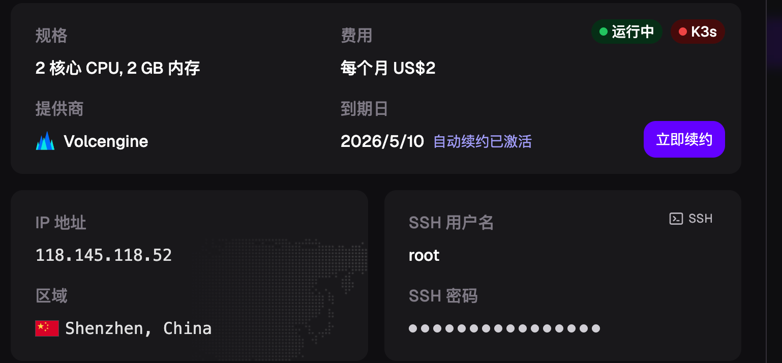

The issue persists, mainly with the following phenomena:
Due to k3s being offline, I reinstalled the Zeabur service, but I encountered an error: Invalid input
Hello, we SSH'd in and took a look:
The host is deadlocked due to "Disk 90% full + CPU/RAM maxed out" ── this is not a Zeabur platform issue, but a typical case of a 2C/2GB instance being overwhelmed by k3s + user services.
Status:
Therefore, the phenomena you are seeing are downstream symptoms:
Recommendation: Upgrade your specifications
2C/2GB is too tight for running k3s + user services; every time the disk/memory fills up, today's situation will repeat. Upgrading directly to 2C/4GB (or higher) on the server page in the Dashboard is the most direct and permanent solution ── the new spec will provide more disk and memory, giving k3s room to operate normally. The upgrade process will also restart the machine, clearing the current frozen state.
If the upgrade process is not smooth or you have any questions, please let us know.
