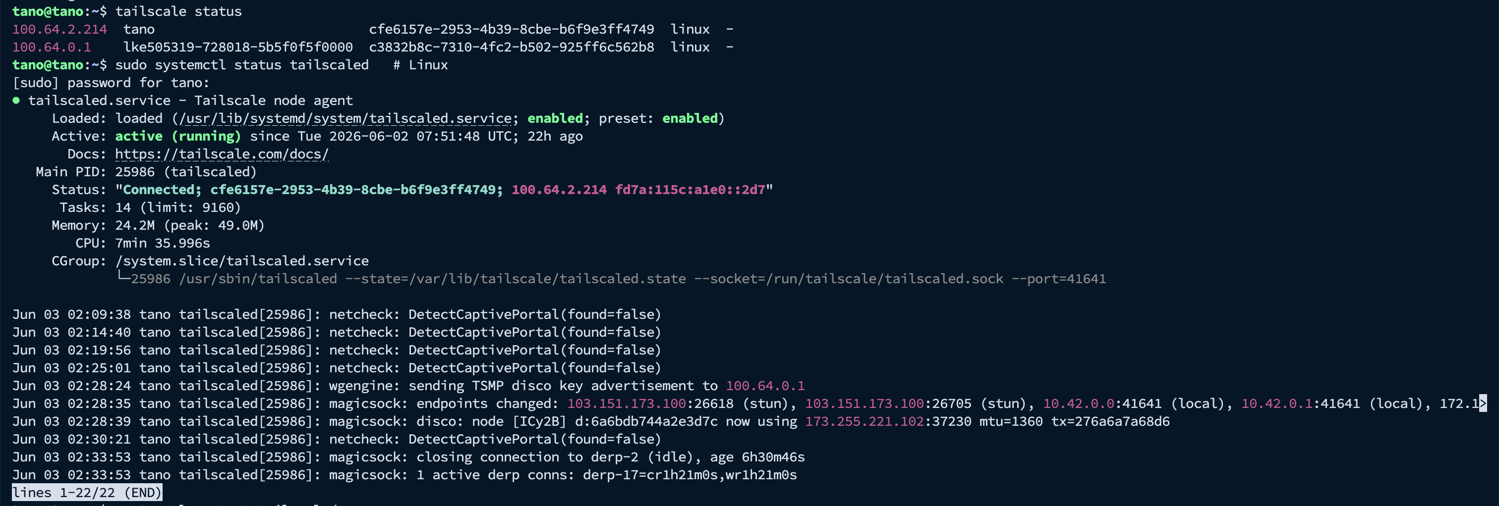

Due to network fluctuations at 02:33:53 AM Beijing Time on June 3rd, the Magic Network Tool disconnected. Although the server network has now returned to normal, the connection has not been restored.

"Tano内网" is a device connected via Wonder Mesh, linked to Zeabur through a mesh tunnel (Tailscale). According to our monitoring, this device has been repeatedly disconnecting and reconnecting over the past day, rather than just a single outage:
When you posted (6/3 approx. 14:40), it fell right into the second outage period, which explains why you experienced "home network is back, but Zeabur still can't connect"—the local network was restored, but the mesh tunnel had not yet reconnected.

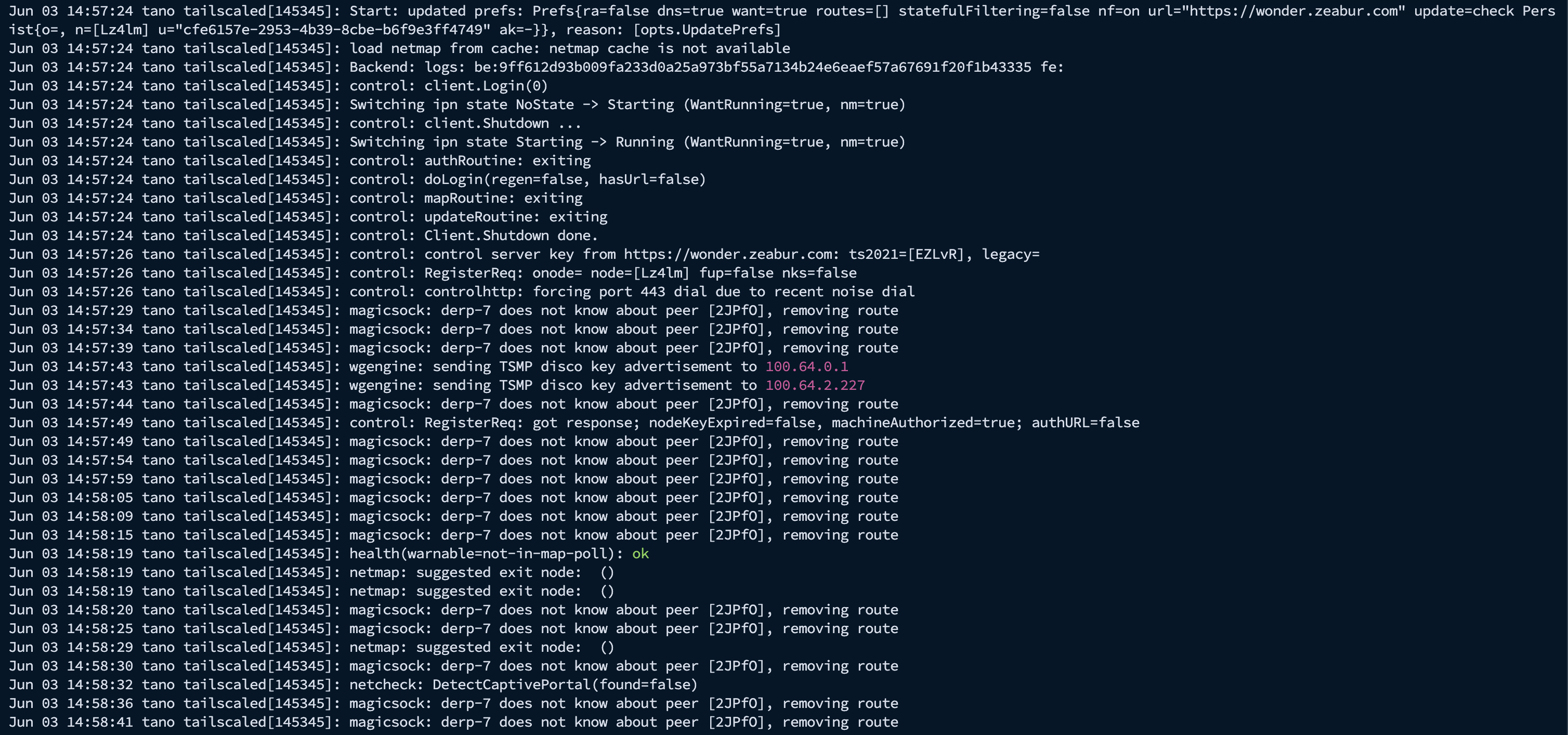

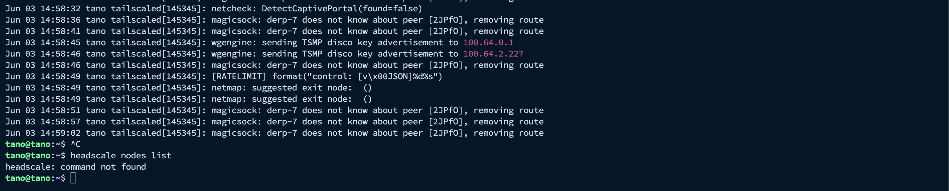

The following error keeps appearing in the client logs:
magicsock: derp-7 does not know about peer, removing route
And the offline node is still visible in tailscale status.

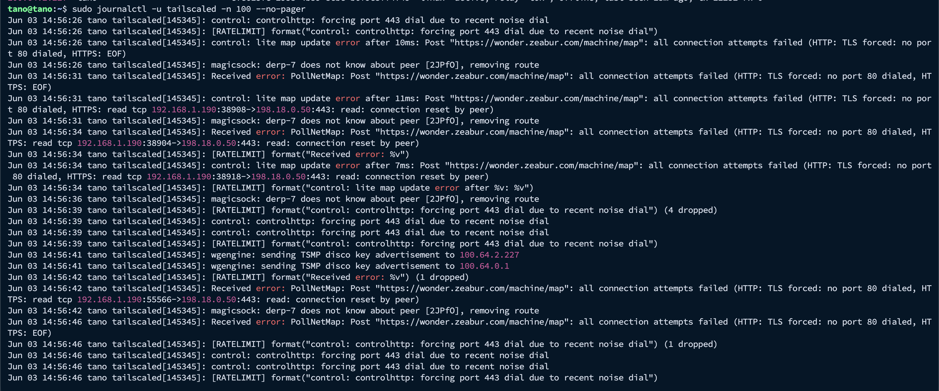

The latest error is: Jun 03 15:38:18 tano tailscaled[719]: Received error: PollNetMap: initial MapResponse lacked node
Tailscale client version: 1.98.4
Control URL:
https://wonder.zeabur.com
tailscaled logs:
RegisterReq: got response; machineAuthorized=true
but immediately after:
PollNetMap: initial MapResponse lacked Node
The node can authenticate successfully, but the control server returns an invalid initial MapResponse without a Node field, causing peer connectivity failure.
Please check the Headscale/Control Server logs and node records for user:
cfe6157e-2953-4b39-8cbe-b6f9e3ff4749
