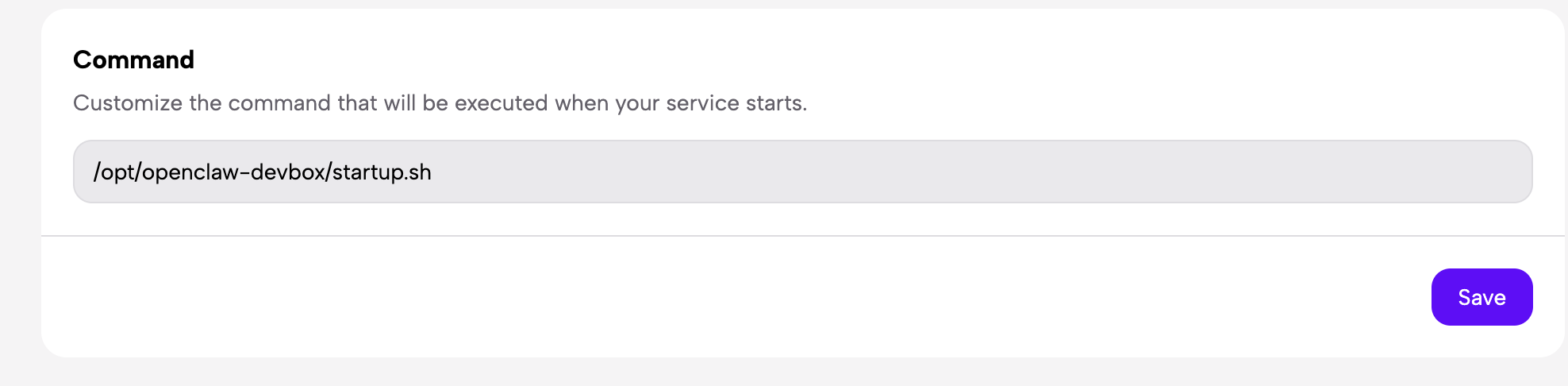

I had try but still crash. Can you please check? 你的專案 OpenClaw 中的服務 openclaw-devbox 有一個部署崩潰了。
ok, start up command is missing

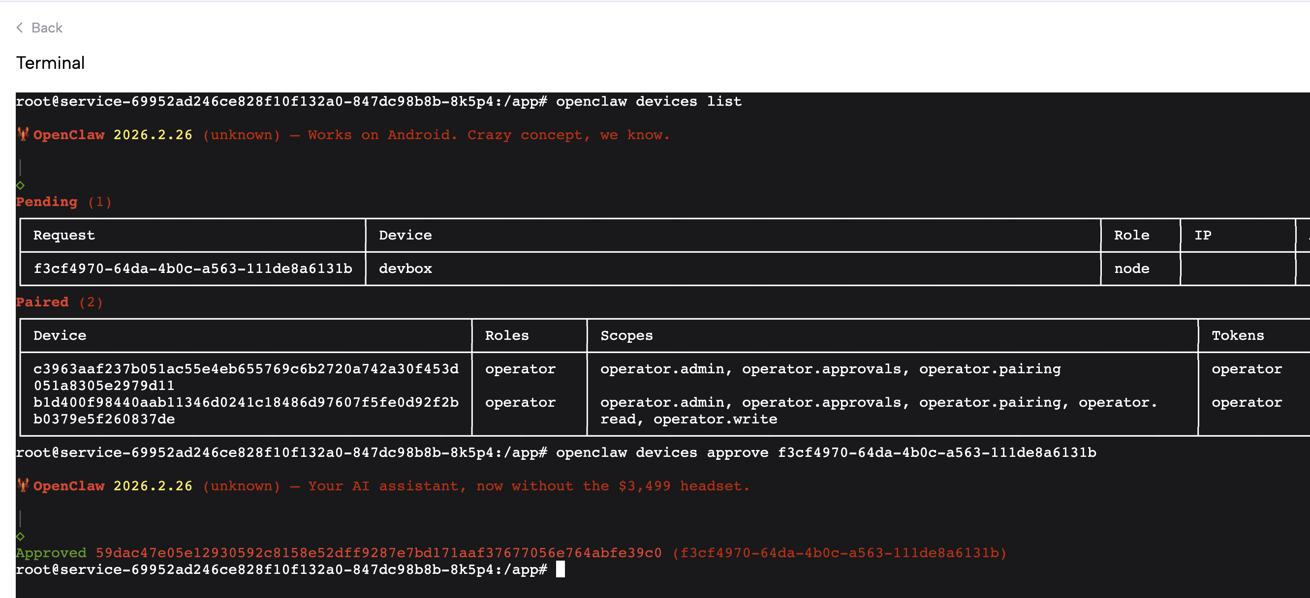

Then enter command like this
openclaw devices list
openclaw devices approve <requestID>
I fixed for you this time.
