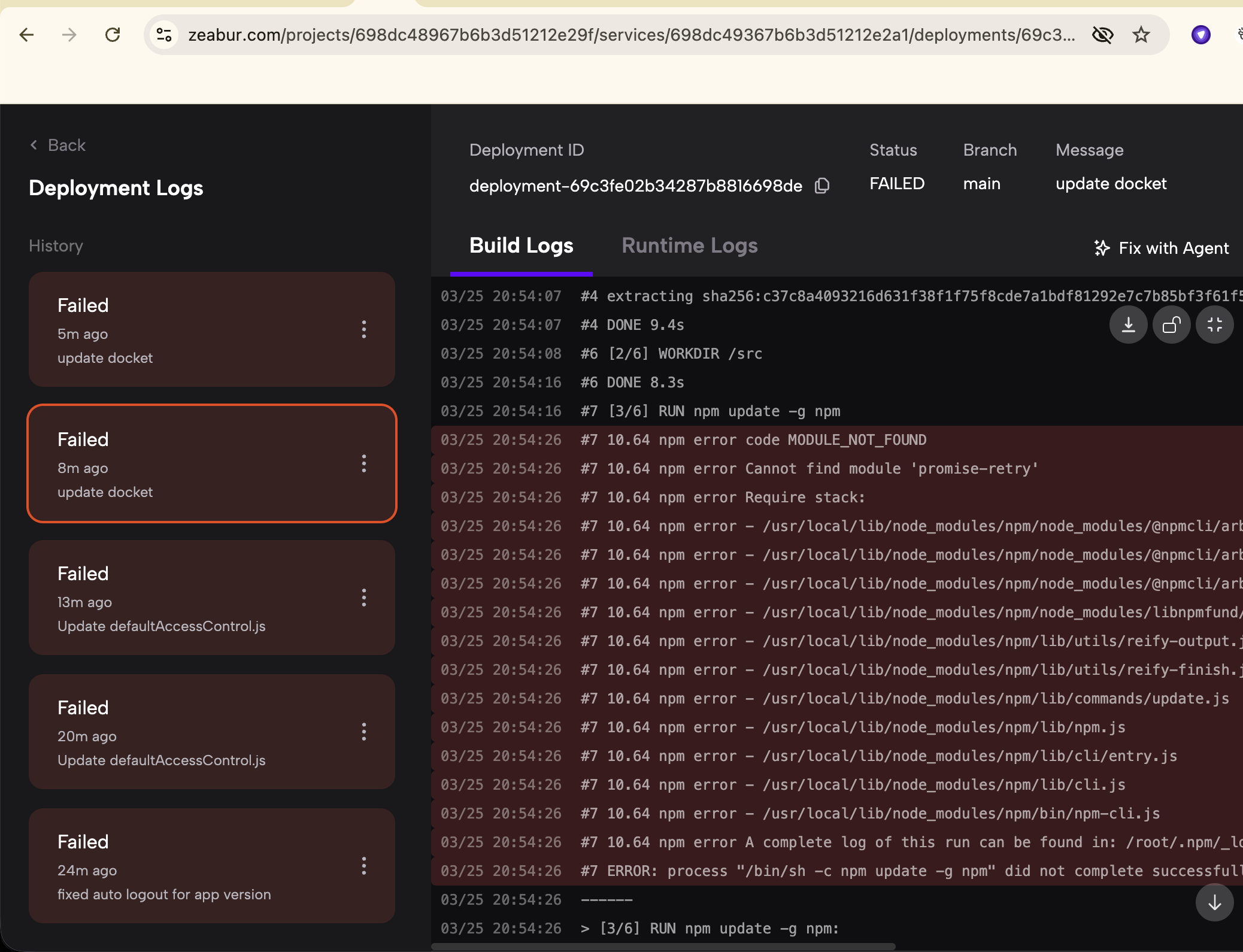

Our frontend service builds have been failing consistently for the past hour. The build fails at step [3/6] RUN npm update -g npm which is injected by Zeabur's build pipeline — this step is not in our Dockerfile.

Error:
#7 [3/6] RUN npm update -g npm
#7 9.663 npm error code MODULE_NOT_FOUND
#7 9.663 npm error Cannot find module 'promise-retry'
#7 ERROR: process "/bin/sh -c npm update -g npm" did not complete successfully: exit code: 1
Key observations:
- Zeabur is using
node:22with WORKDIR/src, but our Dockerfile specifiesnode:20-alpinewith WORKDIR/app— so our Dockerfile is being ignored - The
npm update -g npmstep is not in our Dockerfile; it's injected by Zeabur's build system - The
promise-retrymodule is missing from the bundled npm in the Node 22 image - Previous builds (54 minutes ago) deployed successfully, so this appears to be a recent regression in your build image
