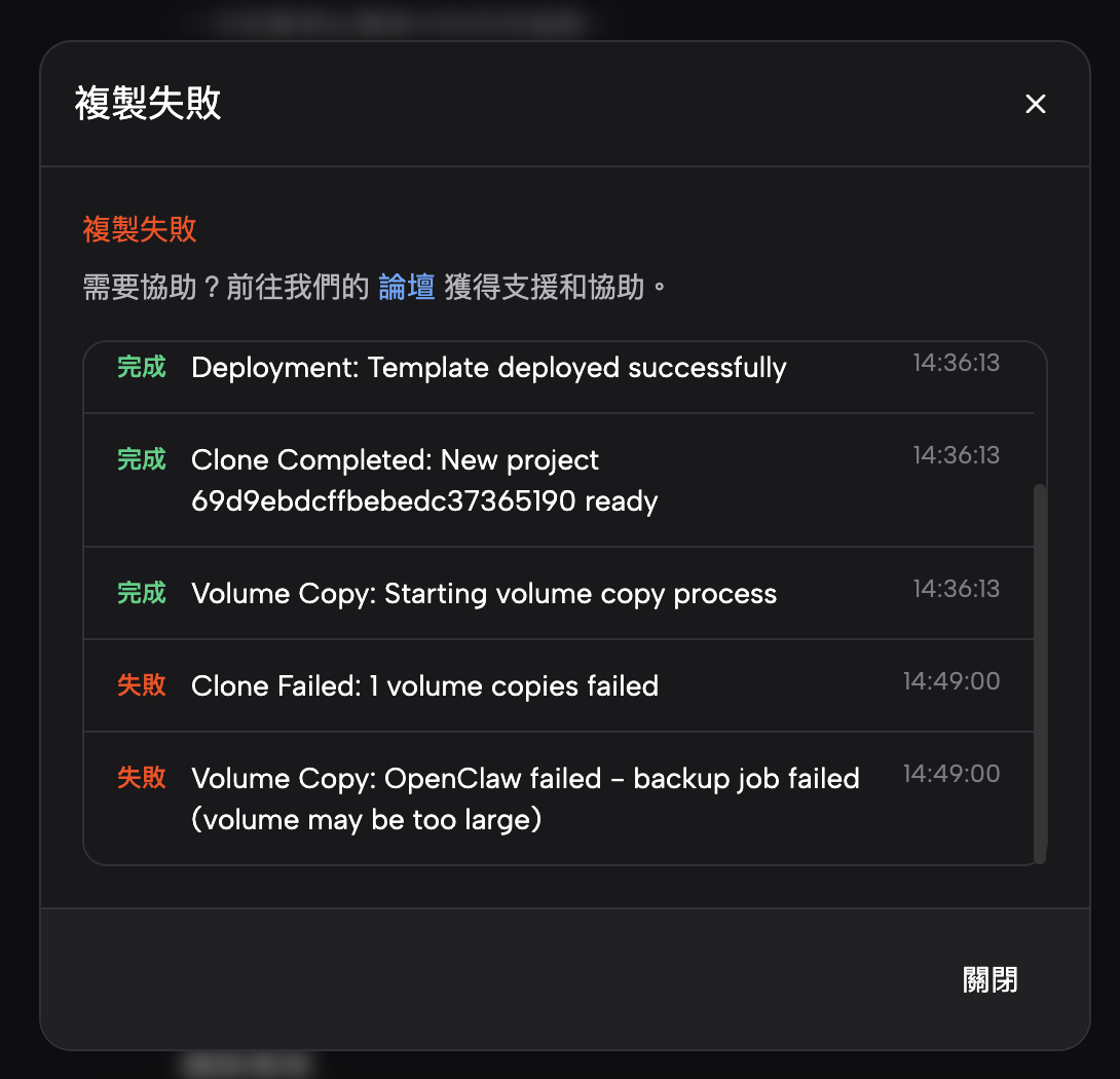

I tried to replicate and migrate the openclaw service to a Hetzner server, but the replication failed. Could you please help me identify what went wrong?
Looking forward to your assistance, thanks.

Evicted: The node had condition: [MemoryPressure].
It looks like the issue was caused by the backup file being too large. We are working on a fix, sorry for the inconvenience! In the meantime, could you please restart your server to free up the memory occupied by this?
I restarted it, thanks!
After restarting the server, I tried copying it again, but it still failed.
The underlying issue has not been fixed yet. It is recommended to use the backup + restore method for now: https://zeabur.com/docs/zh-TW/operations/data/backup-restore

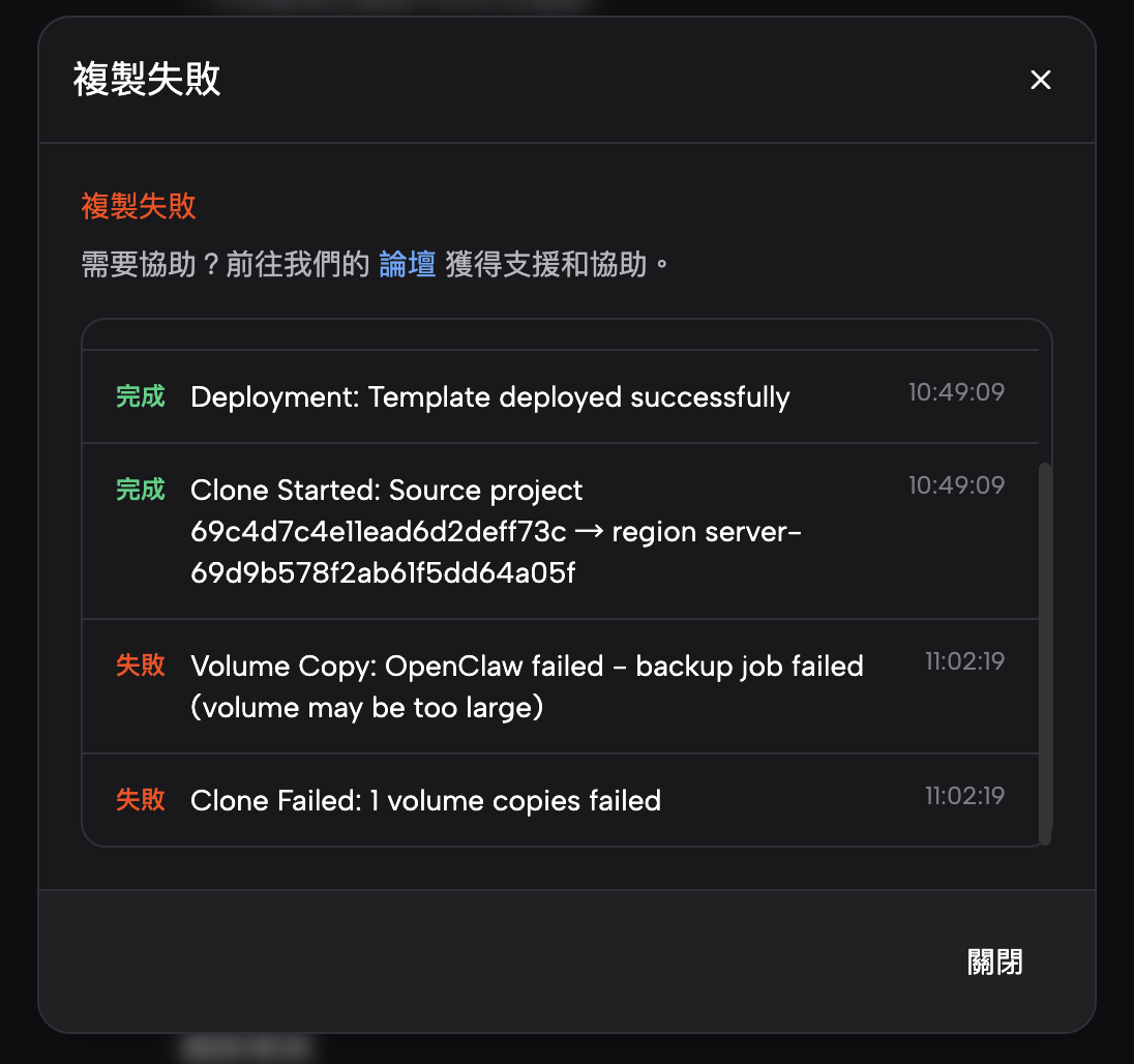

Hi, based on the data structure I see, it appears to be the result of a failed migration (as shown in the failed status screenshot I sent earlier).
Although openclaw starts up normally, none of the data from my old server is present.
Please help me investigate what is causing the project cloning/migration issue. Thank you!
Hello, we have re-examined your migration status and found the cause:
Issue: Only part of the data was copied. Your OpenClaw data on the original Tencent Tokyo server totaled 4.4 GB, but only 502 MB (approx. 11%) was copied during the migration to Hetzner before it was interrupted due to an Out of Memory (OOM) error on the source server. Therefore, what you see on Hetzner is an incomplete dataset, which is why OpenClaw does not have your old data after starting.
