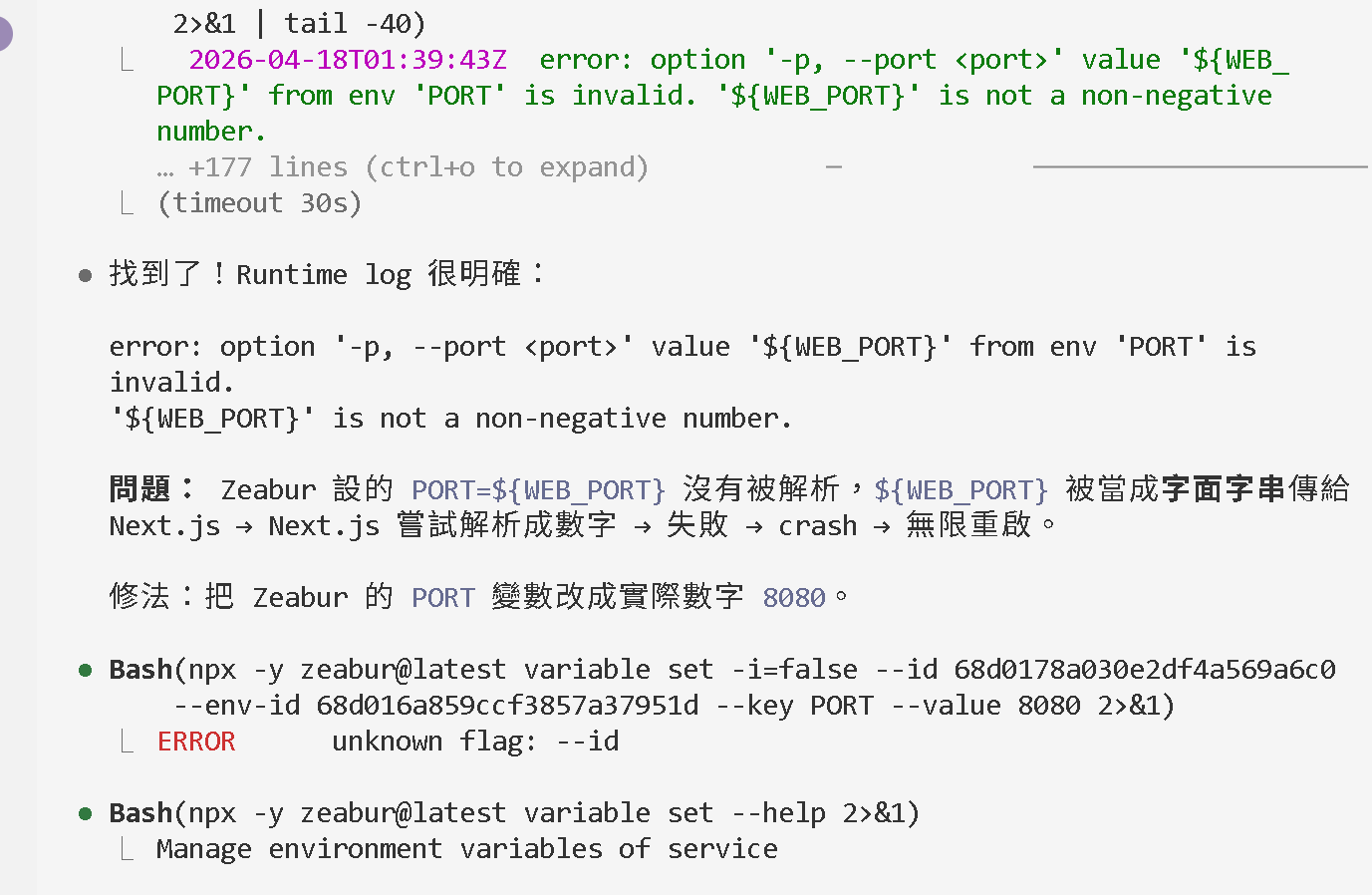

Same question, this variable is very strange:
It is auto-generated—implying that:
However:
Conclusion: 100% contradictory in every way.
I hope the official team can provide an explanation! Thank you.
