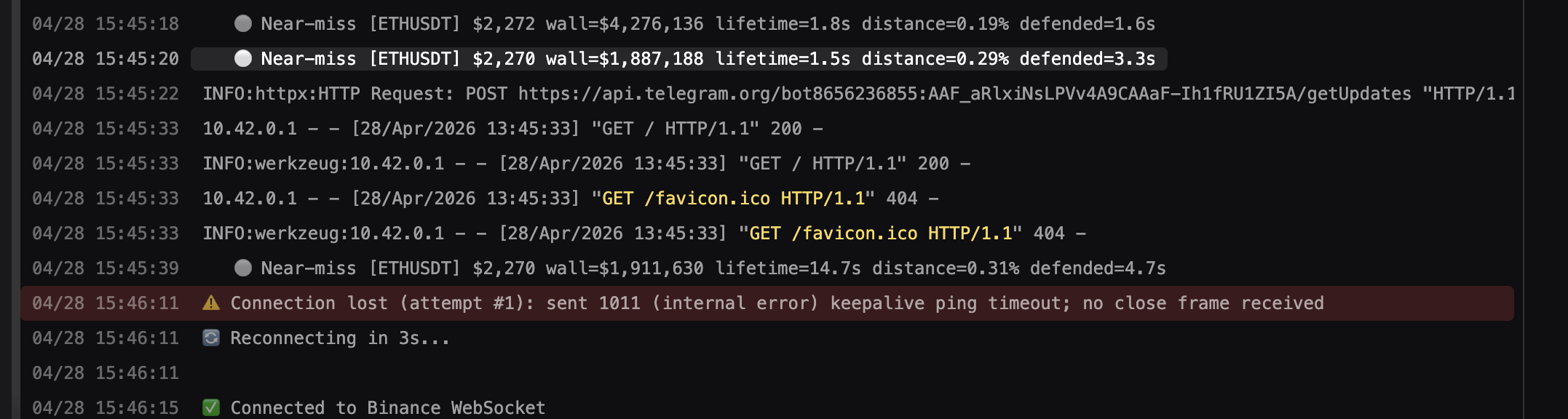

I'm running a Python service on Zeabur using a Hetzner Nürnberg server (K3s). My service maintains a persistent outbound WebSocket connection to Binance (wss://stream.binance.com:9443).
I'm experiencing disconnections every 7-8 minutes consistently with this error: sent 1011 (internal error) keepalive ping timeout; no close frame received

The ping fix reduced drops from every 3-5 minutes to every 7-8 minutes but did not eliminate them. This suggests the issue is at the K3s network layer, not the application layer.
