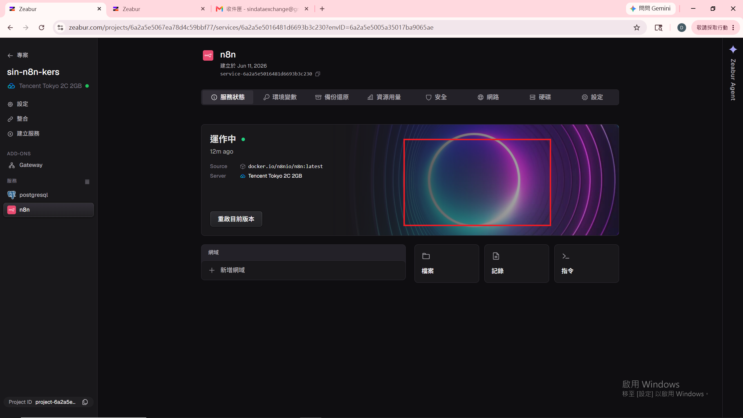

The service has been successfully migrated to the new host, and both n8n and PostgreSQL are running normally. The reason you cannot access the service currently is that n8n on the new host has not been bound to a domain, so there is no external entry point.
It is recommended to first go to the n8n service page in the new project sin-n8n-kers, click "Add Domain" to create a new domain for testing, restart the n8n service after binding, and then log in using this URL to confirm that your workflows and credentials are intact.

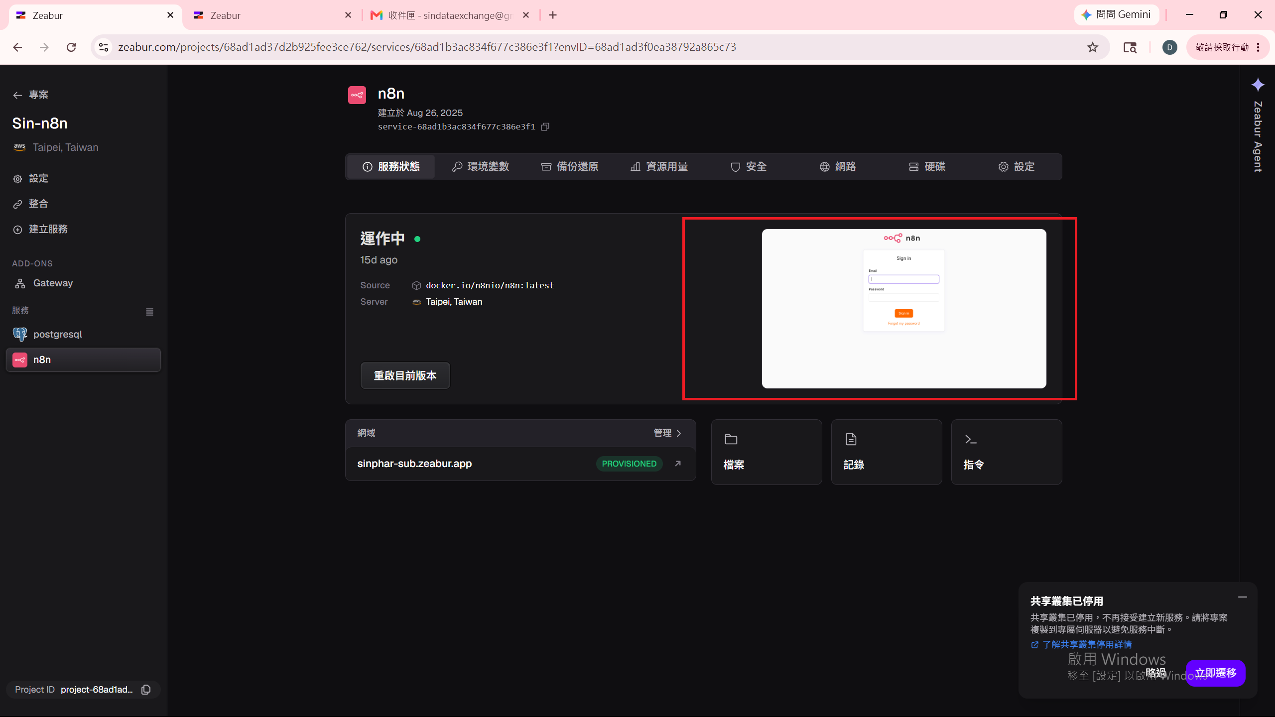

Once confirmed, if you wish to continue using the original URL sinphar-sub.zeabur.app, follow these steps to switch:
- Go to the n8n service page in the old project
Sin-n8n and delete sinphar-sub.zeabur.app in the "Domains" section.
- Return to the n8n service in the new project and click "Add Domain" to bind the same domain
sinphar-sub.
- Restart the n8n service to update the n8n editor URL and Webhook URL to the official domain.
After everything is confirmed to be correct, you can then consider deleting the old project to avoid data loss.
